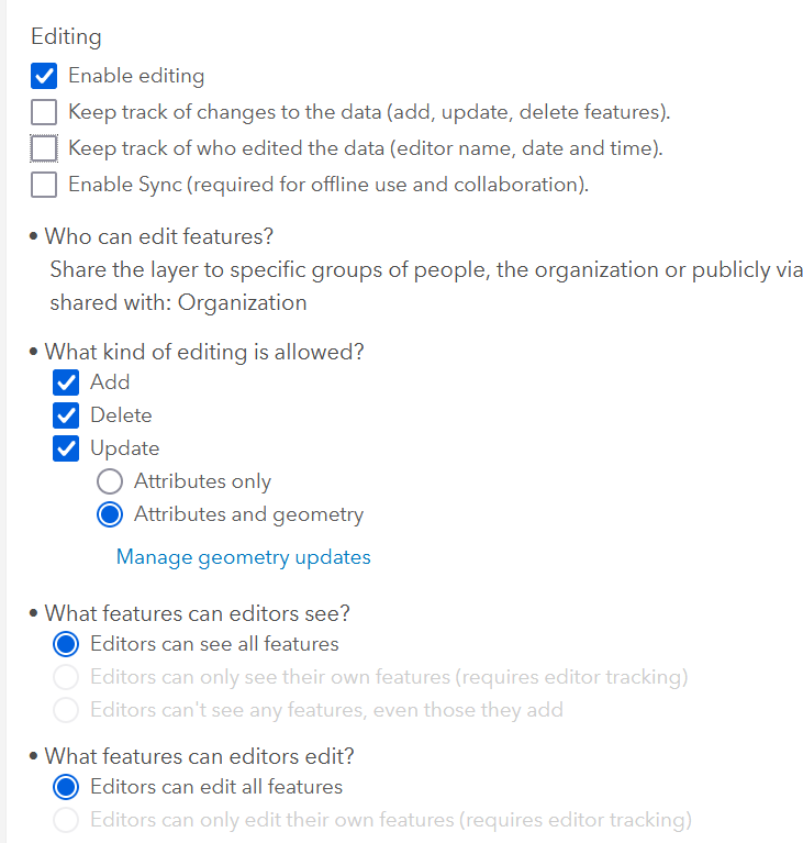

GloriaDesanker
So if I'm understanding this correctly, "Editors can only see their own features (requires editor tracking)" should be checked off? And "Enable editing" should be turned back off? I have tried this and it's not working for me still.capture 2.PNG
