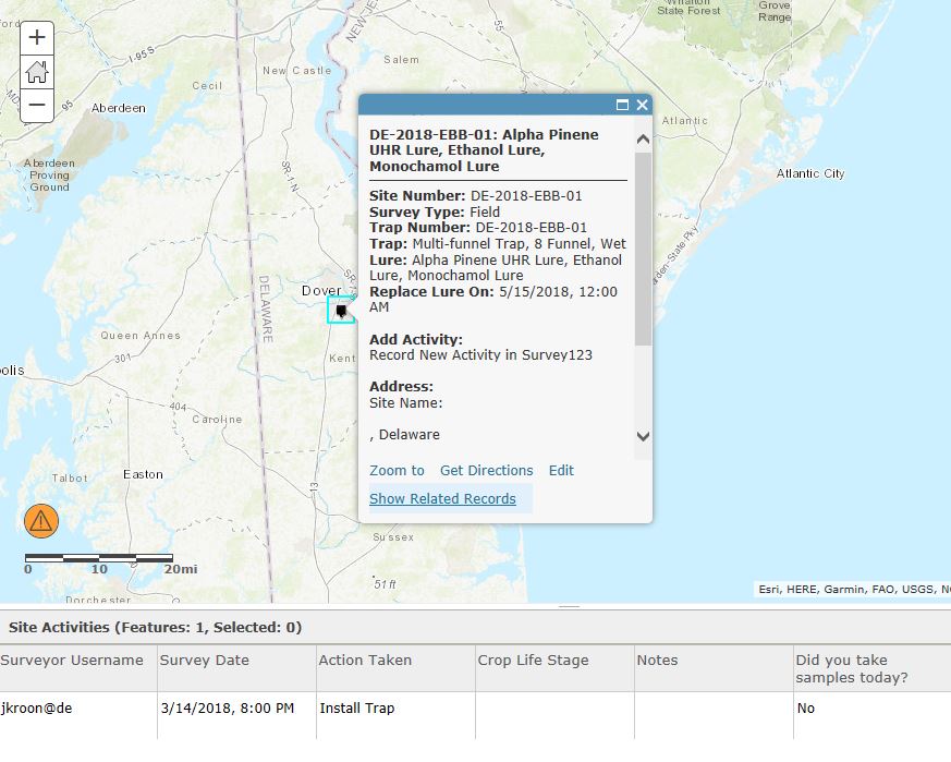

JimmyKroon
At the bottom of the popup should be a link "Show Related Records" that will open a table with the related records.
Related records in AGOL
KenMorefield
Hi Jimmy,
Thanks for the reply.  I'm well aware of the "Show Related Records" option.  That is not the problem.  When displaying the popup for a layer that shares a many to one relationship with another layer, I'd like to display the attributes for the related layer (the one side of the relationship) in the popup, without having to click on the "Show Related Records" link.  What ends up being displayed a is summary count, rather than the actual attributes.
