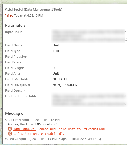

Hi Jake,
I tried it in Pro and got an error code 000852. Could you provide any advice on why I receive this error?
Cheers,
K

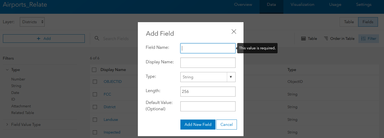

Do you receive an error when you go to the item details in ArcGIS Online > Data tab > Fields > Add?
KerryKang
Hello Jake, I do not see 'add field' option.
I thought 'add field' is not available on ArcGIS Online > data > fields when the data has related tables.

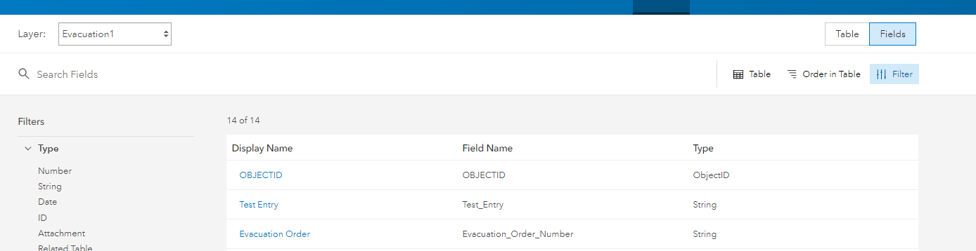

KerryKang
Hi Jake,
It's me again.
I kind of figured out that the reason that I did not see 'add field' option. It was due to my Joined view. After I removed the view I created from join, I was able to see add field option in both feature layer and related table.
Do you think it makes sense?
So lesson here for me is cannot modify data when it has analysis view layer associated with.
