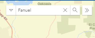

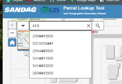

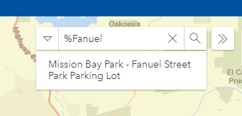

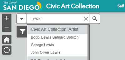

This idea is really to bring back a functionality that previously existed, but was removed in one of the latest releases of ArcGIS Online.
We need the ability to easily search using Contains when searching for features in maps and apps, especially for our City's enormous number of public facing apps that are built for a user who varies wildly in tech familiarity.
The new search update requires the wildcard character % added to the start of the search.
In the past you could search using Contains without the need to designate a leading wildcard character.

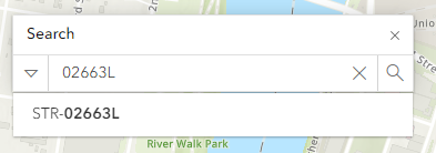

RussRoberts
With the index you do not have to enter in the STR- to search for that location
We also added the ability to add these indexes without having to touch the map or the previous authored search to generate the index. To add your own index you can go to the hosted feature layer, go to Settings tab, and add the index under Manage indexes.
Thanks again for the feedback
