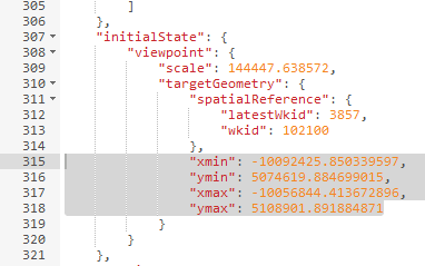

And thanks for the tip @Danny_ATLANTES, I was able to do what I needed there! These are the steps I took:
  1. Head to https://ago-assistant.esri.com/ and log in.
  2. Click "I want to..." then "View an item's JSON"
  3. In the left, navigate to the map whose extent you're looking to copy. Select it.
  4. The right will populate the item's JSON. Under 'Data,' you're looking for a code block that looks like this, probably toward the end. (Ctrl+F and search for initialState or viewpoint, etc.)rburkebsrc_0-1646256613770.pngrburkebsrc_0-1646256613770.png
  5. Copy the 4 lines that include xmin, ymin, xmax, ymax (like above).
  6. Navigate to the other map(s) that you're looking to copy the extent to. Click "Edit JSON" in the top right of the Data box. Find the same code block and paste the values over those 4 lines. Save, repeat for any other maps, and you're done!
You'll still need to be careful to click "Home" before each time you save, or re-do these steps if you accidentally bump it.
I still agree that that's a lot of steps and not intuitive, especially if you're not familiar with JSON (I'm not all that familiar). But, this is a functional workaround for now.
