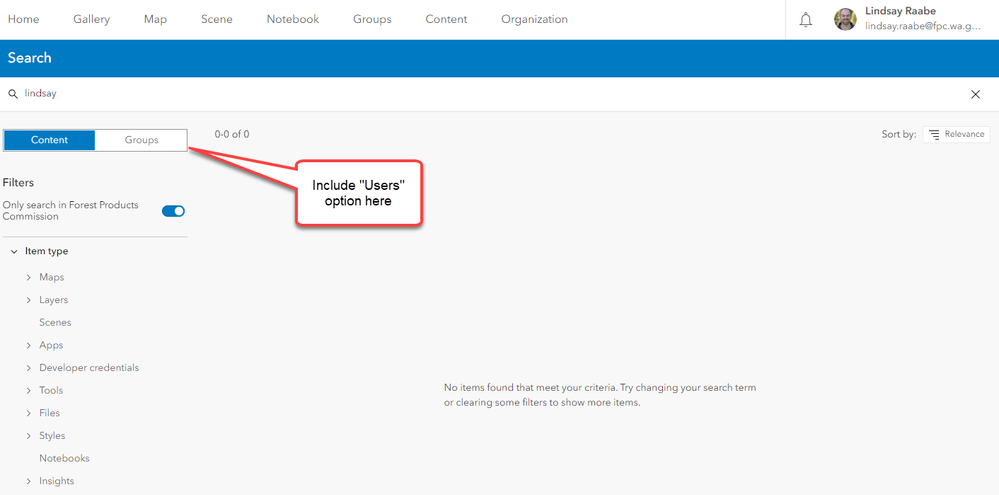

It would be handy if I could search for content by Username in ArcGIS Online through the main search tools instead of having to navigate to Organisation > Members > Content.
I would like to enter a username (or partial username) and see all the content within our organisation that is owned by matching users (include a filter option to only return users instead of content or groups).

Hello - if you use the search function in the content - you can search by username if you enter in the complete username and using this search function.
owner:<username>
Use advanced search—ArcGIS Online Help | Documentation
you could use some Boolean logic to search against multiple usernames
owner:<username1> OR owner:<username2>
But I don't believe it's possible to get a search against partial usernames.
LindsayRaabe_FPCWA
I figured this was possible, but a dedicated ability to search on from the easy-to-access search functions would be handy.
