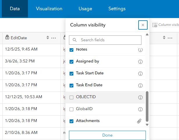

Is there a workaround for this? How can we retain the field visibility settings so they stay as configured without needing to toggle them on or off each time the page (Feature Layer Data tab) refreshes?
As shown in the attached screenshot, I would like the ObjectID field to remain visible by default. Currently, it has to be manually enabled every time the page refreshes.
This is particularly confusing for some non-technical staff, as ObjectID is typically the first field they look for when reviewing data of this feature layer.
timcneil
Hi @GISsolutionIZ ,
Are you the owner of that dataset? If so, you could save a table configuration to the item via Map Viewer (or the Visualization tab). The data tab will honor that table configuration, including visible fields, by default.
Check out this blog (specifically the Table configuration section) for more info:  https://www.esri.com/arcgis-blog/products/arcgis-online/data-management/manage-attachments-and-table...
GISsolutionIZ
Hi timcneil,
Thanks you so much. It worked well!
