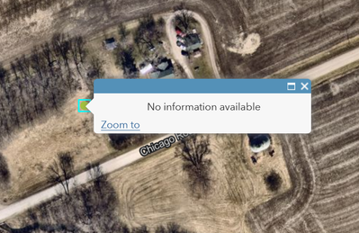

What kills me is that using Arcade, there's currently no problem in getting exactly the sort of result I'm looking for in the expression builder. But try to bring that FeatureSet, or even a single Feature, into your popup:
Sad day.
