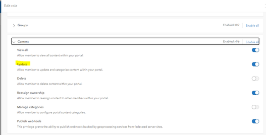

I'm also wondering whether this behavior is not a bug. When you define a custom role that has the administrative privilege Content > Update, through ArcMap it is perfectly possible to republish a service that you don't own!

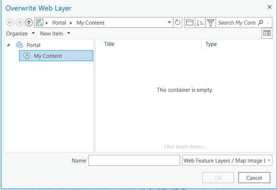

However, in Pro you'll see the following Window:
Only the My Content tab is available. I believe My Groups or My Organization should appear here when logged in with a custom role that has the admin privilege Update Content enabled.
I hope Esri will fix this in a future release of Pro
