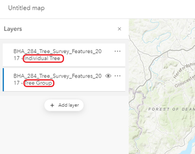

When adding a new layer to a map (in both Map Viewer and Map Viewer Classic; it would be really useful to have the option for the layers being added not to be prefixed by the name of the map service they came from.
If you have a map with lots of layers, manually renaming becomes a tiresome task.
In the example above, I just want the name of the layer as it was published from ArcGIS Pro, not the layer, prefixed by the name of the service.
In fact, i think this should be the default, as the service name is really only used for service management purposes in the majority of use cases I can think of.

As a workaround you can change the display name of the layers in the map.
jcarlson
@DataOfficerSuppose you add a service with a dozen layers, though. It gets pretty tedious.
I'd love the option to just add a single layer from a service without having to add it from a URL, too.

@jcarlson what @RobertThomson  is saying is correct, but you just need to have opened your web map first. The default behaviour of AGOL and Portal when opening it from the item details menu is to add it to the last map that was open.
@DataOfficer , this isn't really a workaround solution you're suggesting though, it's just part of everyone's standard practice to publish a map....and takes forever 😫
I don't know any examples of web maps where the user wants to know the name of the service as well as the layer name when navigating a layer list.
