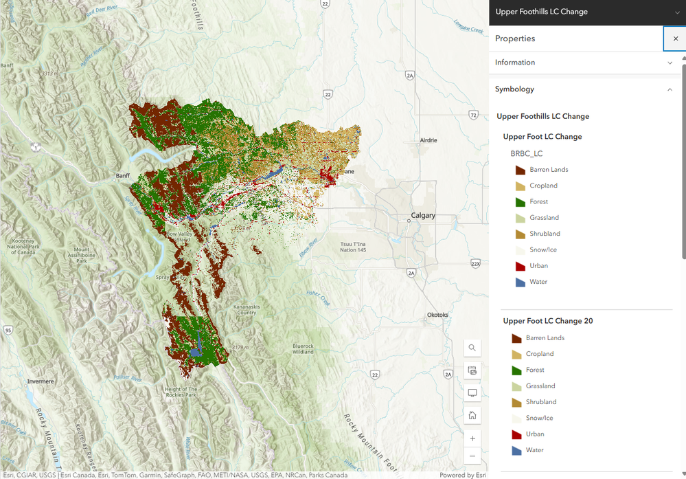

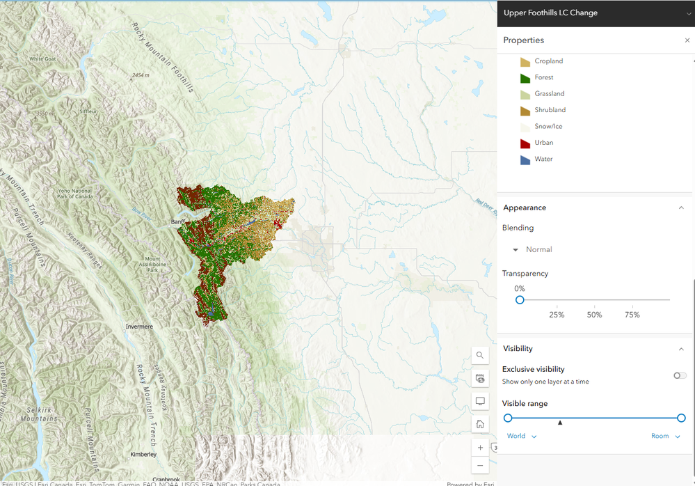

Hello everyone,
I am having troubles with layers drawing properly in AGOL. The layer only draws properly at certain scales. When it is not drawing properly, the layer is patchy and missing sections. I have tried generalizing the data thinking that the data was too large, but that hasn't helped. I have also turned on Optimize layer drawing for all of the layers and it does help but doesn't fully solve the issue. I have had this issue with other layers before and I cannot figure out the best solution to this issue.
I have attached a .ppkx containing one of the layers that is not working properly to the bottom of this post.
Any help is appreciated!
Thanks!

RussRoberts
Can you share a pro project or sd file and we can publish and check it out. Have you also tried rebuilding spatial indexes? thanks!
NolanHoffart
Hey thanks for the reply @RussRoberts. I have tried rebuilding spatial indexes and that also did not help any.
I have uploaded a .ppkg in the post; I really appreciate any help and insight into this.
