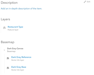

I am trying to clean up items in my AGOL, but it is super hard as I can not tell *exactly* which maps/layers are being consumed and which are not. When you go into a web map, you can see what layers and base maps are being used (pic below) and go to the feature classes there.
I would really like to see this implemented on other things.

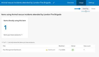

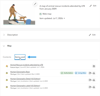

Hey @leahmaps et al! We understand how challenging that has been, not having visibility of where your item is being used. We hope that the latest update of ArcGIS Online provides more insight into these details. For the supported items, you can view the "Items used" tab and additional details of your item's usage via the "Used by" tab. Read more in this blog
Hope this helps!
