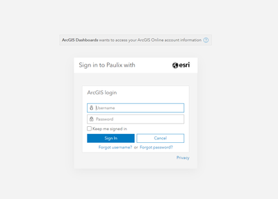

Here is an example from ArcGIS Dashboards which provides the login page, but with no explanation.
Ideally there would be one consistent experience for all apps and it would always:
1) Provide a detailed explanation that normal humans can understand
2) Provide a logout / login page so the end user can resolve the problem
