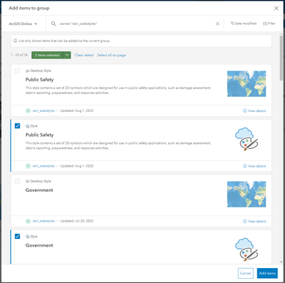

If you are using your own custom web style group I recently added the vector of those under the esri_webstyle account and you can add it to your orgs group.
Under Group > Add Item search ArcGIS Online for owner:"esri_webstyles" and sort by date and you will see those vector options.
AnninaHirschiWyss
Awesome, @RussRoberts  Thank you so much!!
