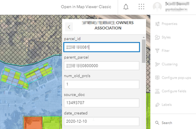

In Map Viewer Classic, the attribute field order for a layer's pop-up is maintained in the editing window as well, which seems to be a natural and logical behavior, because if you wanted the fields to be viewed in a particular order, it stands to reason that you would want to edit them in the same order (it provides consistency and predictability when the attributes are ordered the same in both views).
In the new Map Viewer, however, the attribute field order in the Editor window follows the order of the layer's original attribute table, not the order configured in the attributes pop-up. There appears to be no option for re-ordering the attribute fields for the Editor window, including moving columns in the layer's attribute table.

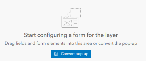

The way to control the order in which fields are displayed in the Editor window is to create a Form. If you have not created a form, the Editor window displays a list of all the editable fields by default.
To get started with forms, select the editable layer, click Configure Editing on the toolbar on the right and select Forms. If you want the field order to mirror the pop-up, you can do that with just 1 click.
Other options include dragging, dropping and reording fields to tailor the form for editing. For more information on configuring forms in Map Viewer, check out this article.

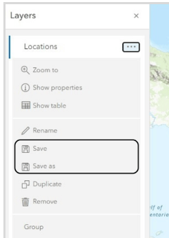

Forms can be saved to the map or to the layer.
Save the Form to the Layer:
  • By saving the form to the layer, the form appears with the fields in the same order every time you add the layer to a map. This ensures consistency and saves you from recreating the form for each web map.
