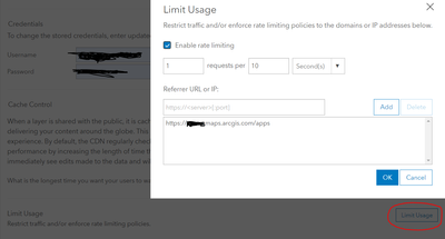

JACooper
After exploring options with an ESRI Support Services representative, it was determined that no current functionality exists with the ArcGIS Python API to limit access / usage for secure services feature layers with stored credentials.
Manually in ArcGIS Online (AGOL) now, one can create a secure service of an existing hosted feature layer by storing their credentials (ArcGIS Online username and password) within the new service itself (see here). After this, one can then alter the settings of the new secure service to Limit Usage of the service by enabling a timed rate limit and specifying very specific IP or URL addresses where the service can appear. Following the documentation in the following links will lead you to this look on a browser:
While it is possible to add a web layer with stored credentials to ArcGIS Online using ArcGIS API for python, there does not seem to be a way to set limited access to these secured hosted services using the ArcGIS python API. This would be a valuable feature for organizations that want to be able to use the AGOL platform to publicly display and share data with personally identifiable information while protecting that data from full public access. Particularly in combination with Hosted Feature Layer Views (see here and here), these secure services can allow curated snapshots of datasets that include data that the publishing organization or their data partners/stakeholders do not want to be accessible to the general public in ways that public feature layers are on AGOL.
Current workflows are still being explored on how to circumvent this python API limitation by using python in combination with other API services like JavaScript API and REST API. However, the ability to achieve these ends all from within the ArcGIS python API itself would be a valuable feature.
