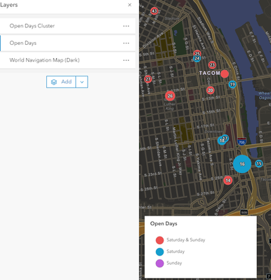

My work around was:
1. In map viewer, make a copy of the aggregated layer and disable aggregation.
2. Make sure the copy has symbology that matches the aggregated layer. Set the points for the copy to be slightly smaller than the points used in the cluster layer so they are hidden when things become disaggregated at a large scale.
3. Make sure the copy is underneath the cluster layer so that the points are hidden.
4. Turn off popups/lables from the copy.
5. Remove the aggregated layer from the legend.
Final result (the numbers do not correspond to the number of features in the cluster, but they could):
JasonHildrethCityofTacoma_0-1692901257536.pngJasonHildrethCityofTacoma_0-1692901257536.png
