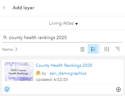

BronwynDitchburn
I can't see 'Country Health Rankings 2020 ' under Living Atlas  , has it been removed ?
RussRoberts
Esri Notable Contributor
@BronwynDitchburn It should be County and not Country 🙂

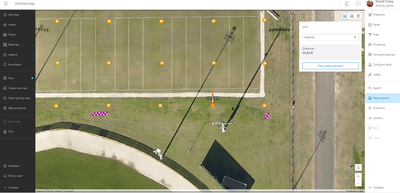

DavidColey
MVP Frequent Contributor

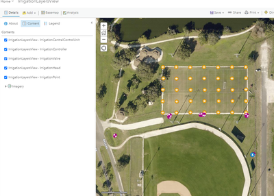

Hi - there seems to be an issue with Map Viewer Beta and coordinate transformation.  I have a hosted feature layer collection in Florida West State Plane HARN (2882) coordinate system.  The layer contains valve and irrigation head points.
When I add the service to the current map viewer (soon to be map viewer classic), the points are positioned correctly along the north-south (x-axis).
When I add this service to ArcPro 2.7.2 and apply the transformation (NAD 1983 HARN To WGS 84 2) the points are also positioned correctly along the north-south (x-axis).
However, when I add this same service to a map viewer beta there is a noticeable shift to the south of some 10 to 15.
Here are some screen shots:
Map Viewer Classic:
Map Viewer Beta:
Clearly there is an alignment / transformation issue.  Sadly, the issue persists when I add a map (either built in classic or beta) to a 4.x configurable app such as the interactive legend app.
Here is my feature layer collection:
https://sarco.maps.arcgis.com/home/item.html?id=e71620a6b1a846ce8cb7ef5238f3a847

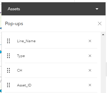

PeterKing4
@JenniferWrightsell-Hughes
How can we select which fields can edited in the New Map Viewer?
Currently ALL  fields in the pop-up can be edited when moving to the new version. I don't want people to have the ability to edit all fields but I do need them to be visible in the pop-up.
This is the classic viewer with the option to select fields that users can edit.
Peter King
@PeterKing4 - The ability to select which fields are editable is not available in the new Map Viewer. We are planning to implement field configuration through the layer item page in a future update of ArcGIS Online. In the meantime, you can still use Map Viewer Classic for this workflow. Hope this helps!

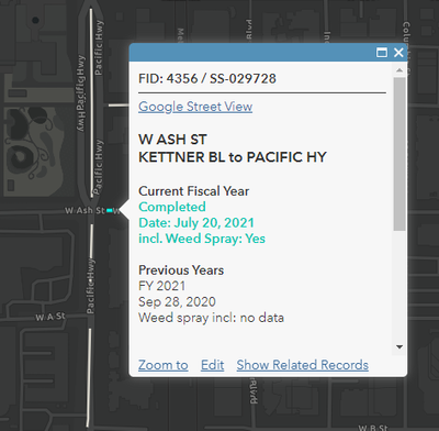

BrittanyBurson

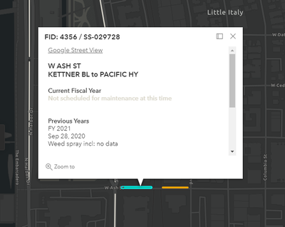

I have weird variances with calculated Arcade expressions only displaying the "Else" value in the New Map Viewer, which populate into my JS 4.x Dashboard as well.
The "Previous Years" historical text is an Arcade expression returning fields from a related table using FeatureSetByName, and is successful in the New Map Viewer. So maybe it's the HTML... or the use of domains in expressions? Or? Any suggestions welcome.
Thanks!

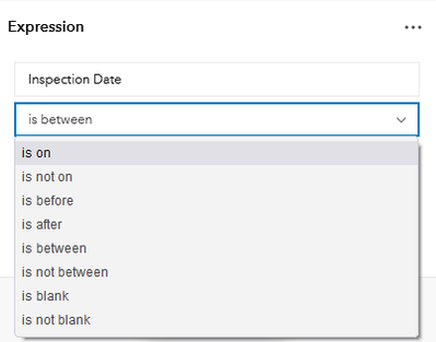

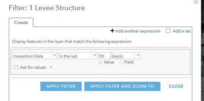

Posting hoping for same functionality as Classic Map Viewer when filtering by date, to support "in the last" X days/months/years:
Option available in Classic Map Viewer -
New Map Viewer options -
My use case is filtering to show only the most recent quarterly inspection ("in the last 90 days") in the map in Field Maps. If I make or save this setting in Classic, I lose all of my Field Map configuration. I did find I can still control this through use of a View >> Visualization, but it would be nice to not need an extra View layer to do this.
I didn't seem to find a way to use Arcade to do this, but if I missed it, please let me know. Thank you
Edit 08/03/21: to clarify, this is a hosted feature layer in Enterprise Portal 10.8.1

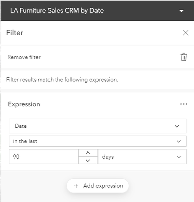

@BrittanyBurson   Are you using a hosted feature layer? Currently we support these relative date filters on hosted feature layers.
BrittanyBurson
Hi @RussRoberts thanks for the reply! I just realized I didn't specify my data type earlier. Yes, this is a hosted feature layer hosted in Enterprise Portal 10.8.1. What version/environment is your screenshot from?
RussRoberts
this one is from ArcGIS Online so not 100% the same as enterprise. I can see where the differences are. Are you using this map viewer in Online or the beta install with enterprise.

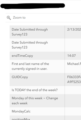

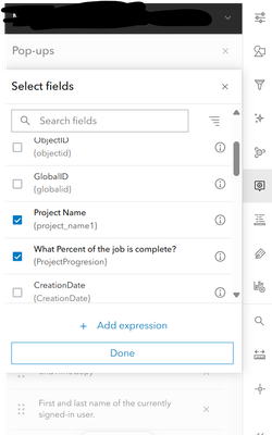

Survey123Jedi2023
Hello @JenniferWrightsell-Hughes,
My colleague has been sharing this pain point with me for a long while. And today, it happened again, and I decided this was his cry for help, and I'm the one to get it fixed.
When using a Survey123-hosted service and creating a popup in Map Viewer, the fields auto-populate in ABC order (straight from Map Viewer).
--- https://services1.arcgis.com/ Here's the first part of the URL to my work
When I tested it, starting with the Project Name and Percent (because that's how the survey was built) 
 And this is how the popup populated, even after I turned on and off the toggle button.
I was told this doesn't happen if you load the same schema from ArcGIS Pro, but I didn't test that because he said it works.
Can you get this to the powers that be? I didn't see a group in the community for Map Viewer (but I may have missed it).
The most fantastic fix would be to sort the popup like the AGOL schema from the beginning. This would save many hours of hair-pulling and workarounds.
~~~ The workaround is to change the labels so they sort correctly in the popup.
  • A1. Bird species
  • A2. How many
  • B1. Plant Species
  • B2. Something about plants [I'm smiling too]
Thank you!
~ Michelle Williams
I checked my personal Esri account, and it works great.
https://services3.arcgis.com/ Here's the first part of the URL from my account
@Survey123Jedi2023 - I'm not sure how to resolve this issue. I think your best bet is logging a Technical Support ticket so they can troubleshoot with you:
https://support.esri.com/en/contact-tech-support
Hope this helps!
