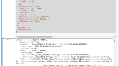

by Anonymous User
Not applicable
Hi,
So I got the Jupyter Notebook open, I saved the attachment, and went in to customize the code to my needs. Ran the code and got this error:
NameError Traceback (most recent call last)
<ipython-input-2-17b343b15353> in <module>
9 "start_time": "2017-08-16T09:06:05.091046Z"
10 },
---> 11 "scrolled": false
12 },
13 "outputs": [
NameError: name 'false' is not defined
I'm trying to figure this out in the mean time, but please let me know if you can help me.
@MichaelKelly
Felicitychun
Hi @Anonymous User
looks like 'false' there in your code is not in brackets as a string so is trying to refer to a variable that has not been defined. In python I believe the keyword for the boolean true/false is with a capital: False
Hi anyone interested, thought I'd post my solution to my question above,
I've gotten my parent global ids using this line:
featureGuIds = featureLayer.query(where=featureFilter,out_fields=['globalid','objectid'], as_df=True,return_geometry=False)
And then I could get it when I iterate through to get the attachments as well as the object id:
currentObjectId = featureGuIds['objectid'][j]
parentGlobalId = featureGuIds['globalid'][j]
by Anonymous User
Not applicable
@Felicitychun Thank you for your response! It seems that your suggestion resolved that error.
Now when I run the script, it seems to feed me back the code, and the file path I tried to feed the attachments in was empty.
I really appreciate any response! A newbie to python and trying to improve!

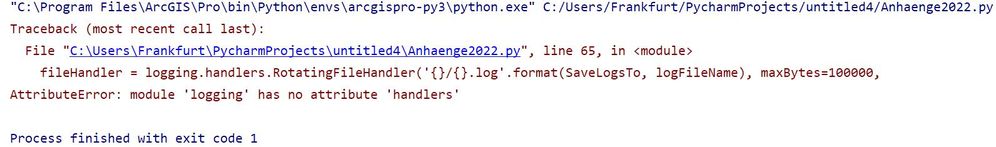

PatrickKK
Hi Michael.
We used your script from time to time with great success.
But lately it stops with an error.
Any ideas?
Thank you 🙂
