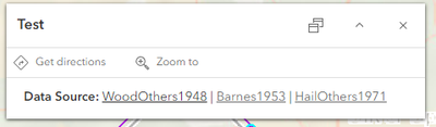

This returns this popup, with each link functional

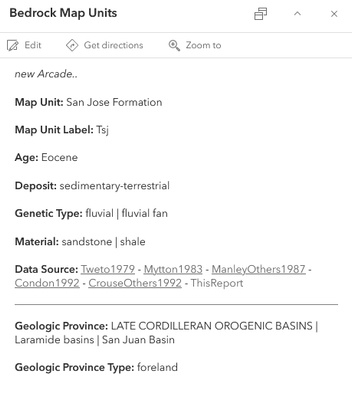

Paco
@KenBuja!   Thank you!   I just wasn't sure how to extract that array correctly,  this worked great.   I just replaced your dummy variable list with my polygon $feature layer, and used an existing Table that included the Codes and URLs, and the array was built off that.
Thanks for looking at this so quickly.  it definitely takes an extra second to think when it needs to sort thru a longer array list,  but it outputs what I need!
here is an example of the new popup output, with active href links>

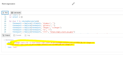

I have run into something that is making me crazy! The code below modeled after your example is being used in a popup Arcade element. Its basically looping through a table of images and I’m reformatting the string into a usable URL. It seems to work when I run it in the code window, but it fails to render the links in the popup. I think it has something to do with the loop but the text that is output in the run looks correct.
Any advice? (see images below)

KenBuja
MVP Esteemed Contributor
That code should work. Did you check whether you're getting any valid related records? It would be something like this (untested)

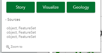

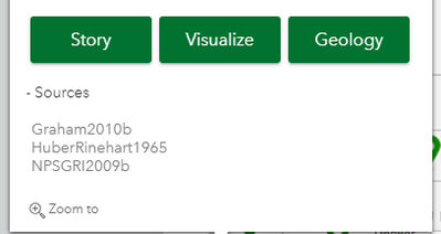

now I am building another JS(4.x) application using expressionInfos, and cannot seem to retrieve the related Table records to href those returns?   I can see the Feature array('dsource') just fine(image one) but I only get "object,FeatureSet" after trying to Filter the table('pub')..albeit the correct number of objects shows.
any help here?  the straight Arcade script you helped build works fine in a similar scenario using a MapView.  but this time I am accessing the Table using FeatureSetByPortalItem,  which shows the correct number of object rows so im assuming I am accessing correctly?

KenBuja
When posting code, please use the "Insert/Edit code sample" button. It makes it easier to read and refer to line numbers.
You're pushing a FeatureSet into the output array. You have to loop through the records in that FeatureSet and push each link into it.
