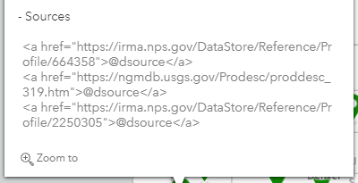

Hm.  just returning a blank entry now.   and again the "$" before the 'dsource' is throwing a "Uncaught ReferenceError: dsource is not defined".   and if i remove that "$" it just returns blank with no error.
this syntax is getting frustrating..since I know your code has worked in the past 😞
Paco
UPDATE.   okay,  I am now returning the correct number of entries and the correct URLs.   but the return is returning as a string between the href single quotes..
I believe i was missing the "@" symbol for the Filter variable(@dsource)

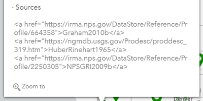

push(output, '<a href="' + f.URL + '">' + dsource + '</a>');
Paco
Again,  sooooo close!   im still getting that full string between the single quotes?   ..but it is adding the 'dsource' correctly now  🙂    just need to get the string to be read as html and we'd be in business!   ..this is exciting(for me at least!).   this is where i wished those literal backticks would work..?
KenBuja
MVP Esteemed Contributor
Usually links get sanitized with a simple return, which is why you have to use an Arcade element with popups for html elements.

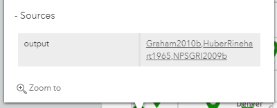

Well not exactly sure what your response exactly means,  but in this Return the href links are active and exactly what I need,  but the type of text return format is not what im looking for.
is there a way to remove the default Table formatting and return a plain text datatype and keep the active links?
