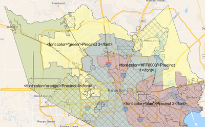

I'm using the font html tag and the color attribute to return colored labels.  I've read online that arcade supports this html tag.  Here is my script:
var pct = $feature.PCT_NO;
var label = "Precinct " + $feature.PCT_NO;
var color = when(
  pct == 1, "#FF0000",
  pct == 2, "blue",
  pct == 3, "green",
  pct == 4, "orange",
  "black"
return "<font color='" + color + "'>" + label + "</font>";
What is returned on the map is not colored text, but the actual html text in black.

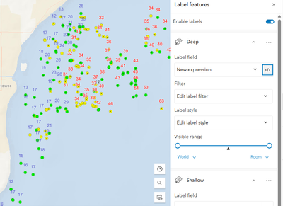

Unfortunately, unlike ArcGIS Pro, you can't use formatting tags in a label in a web map. The way around that limitation would be to use a different label classes for each color.
For example, these labels were created using two label classes
The Deep label class uses the expression
if ($feature.Depth_ft > 30) return $feature.Depth_ft
while the Shallow label classes uses this expression
if ($feature.Depth_ft <= 30) return $feature.Depth_ft
