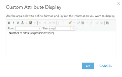

Hi @XanderBakker , I am doing something similar but using the expression in a custom attribute display, and therefore do not have the option to round the result afterwards.
The expression is as follows:

The test shows the number formatted correctly, but in the popups it still shows 2 decimal places. This is how the popup is formatted:
XanderBakker
Esri Esteemed Contributor
Hi @DataOfficer ,
The same applies. In the list of fields you will need to specify the decimals for the (virtual) field "expression/expr2".
DataOfficer
Ah got it, thanks.
