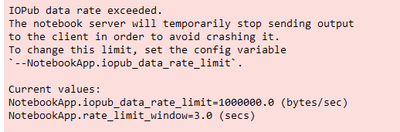

Hey all,
Not sure if this has been posted before, but I cannot seem to find it.
How do I set this variable within the Python Notebook, or on the Notebook server itself:
Unfortunately we seem to have more than the data rate limit, and it has caused quite a lot of issues.
I assume this is quite easy to set, but I have not been fruitful in my efforts.
UPDATE: As another question to keep everything together, how is this done on the AGOL Notebook?
Thanks in advance!
Cody

for what it's worth, I had the same issue (Notebook in AGS Pro), I open a Support ticket and below is how I solved MY issue:
- I was trying to loop through an item list (3400 records), I was having a bunch of "print" statement an I was trying to write into a CSV...
Solution:
- Stop all printing statements
- use logging instead of writing to the csv file
I was able to complete my process.
