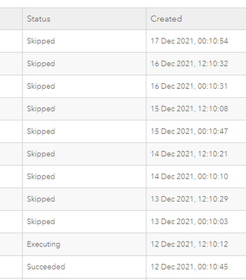

I have a notebook script which runs fine manually, and runs okay on a scheduled Task most of the time. But a few times now the the Task will go off at its scheduled time and then get stuck 'Executing' perpetually. This causes each subsequent scheduled execution to get 'Skipped' (see attached screenshot). This doesn't ever seem to resolve on its own. I've let it go on for a few days to see what would happen, but it never resolves.
The only way I've found of fixing it is to delete the Task from the Notebook entirely. (I also clear and restart the kernel, but I'm not sure that's necessary to fix the issue or not).
I'm not really sure how to troubleshoot this further. I don't get an actual error code, since it is still 'Executing', so I have no idea where or on what it's getting hung up on. Again it runs fine manually, and I've seen it run up to a few dozen times before hitting this 'Executing' snag, so the problem seems inconsistent. I've started tracking the days and times it happens, but don't see a clear pattern yet, other than it might have something to do with the weekends.

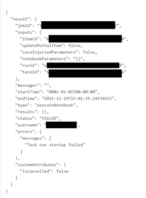

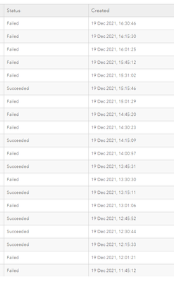

thanks @RobertAkroyd1 i recreated the task and it worked twice and failed once and i noticed on my other Notebook thats setup to run every 15 minutes its failed more times than its ran yesterday, in fact its not even tried to run since yesterday afternoon
i guess there are some serious issues going on at the moment, maybe its all linked to the other issues i have been having around not being able to export surveys from Survey123, it all seems to have got worse in the last two weeks since the AWS issue
thanks again
