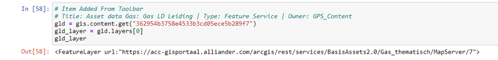

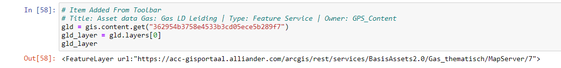

I get a layer from my ArcGIS Enterprise:

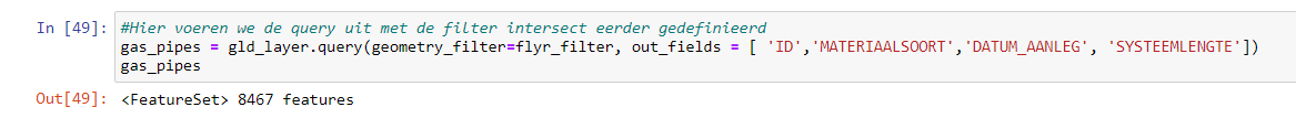

I do a query with a geometry filter on that layer and specify the out fields

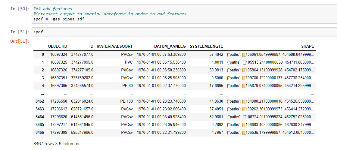

And from the result I get the spatial data frame:
Note that all dates in DATUM_AANLEG column are close to unix epoch time.

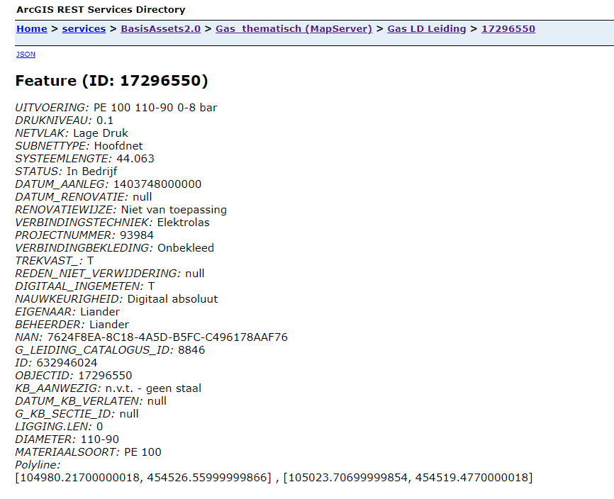

When I get feature with OBJECTID 17296550
and I convert the date manually, (javascript console new Date(1403748000000) ) I get Thu Jun 26 2014 04:00:00 GMT+0200 (Midden-Europese zomertijd), which is the correct date.
Clearly, something goes wrong when querying the service and converting the results to the spatial data frame. But I do not see where and how I can fix it.

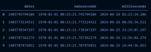

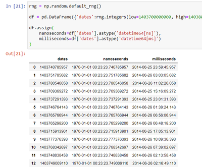

I believe the issue here is that pandas infers timestamps to be in nanoseconds, according to the docs.
To address this, you'll need to explicitly tell pandas that your timestamps are in milliseconds.
Consider the following code block and its output:
rng = np.random.default_rng()
df = pd.DataFrame({'dates':rng.integers(low=1403700000000, high=1403800000000, size=20)})
df.assign(
    nanoseconds=df['dates'].astype('datetime64[ns]'),
    milliseconds=df['dates'].astype('datetime64[ms]')
Looks familiar!
In your code, just append ".astype({'DATUM_AANLEG':'datetime64[ms]'})" after "sdf", and that should get you on the right track.

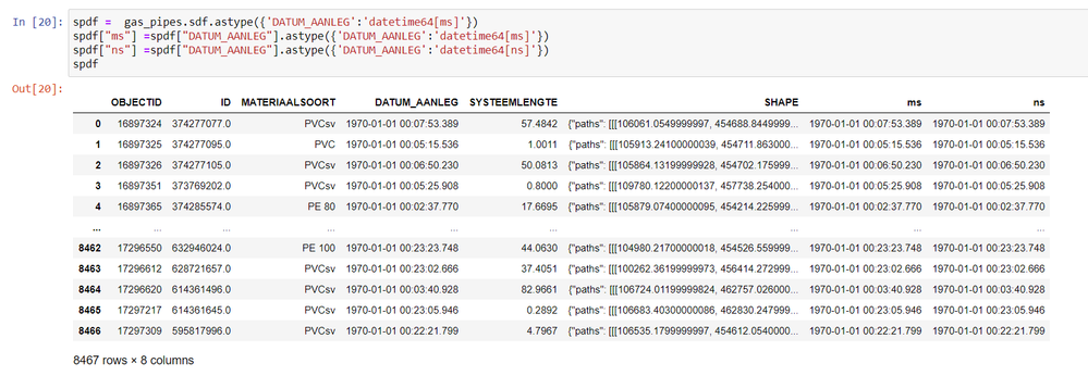

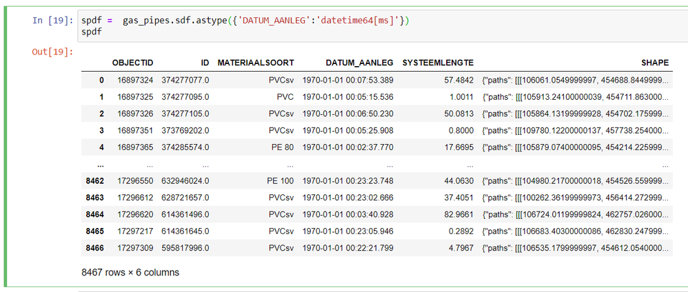

I tried your suggestion this way:
But that didn't make any difference. I'm not sure whether I did that right.

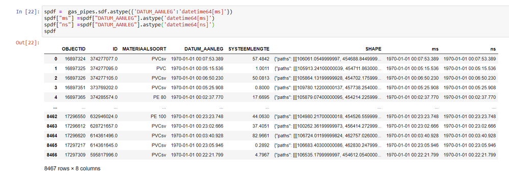

I also tried this:
but that doesn't fix it either.

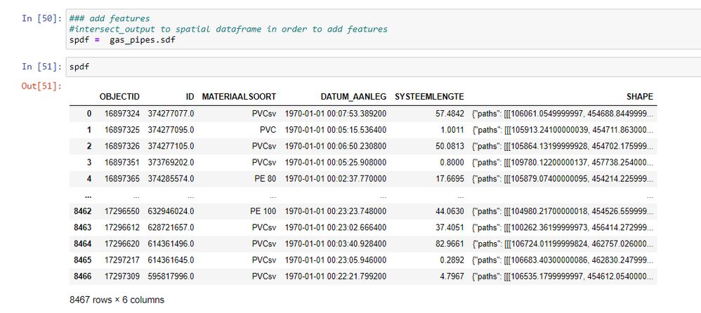

And finally:
It clearly shows though that I'm new to panda's and don't know what I'm doing 🐼
Your code sample looks fine on my Notebook server
Any other suggestions?

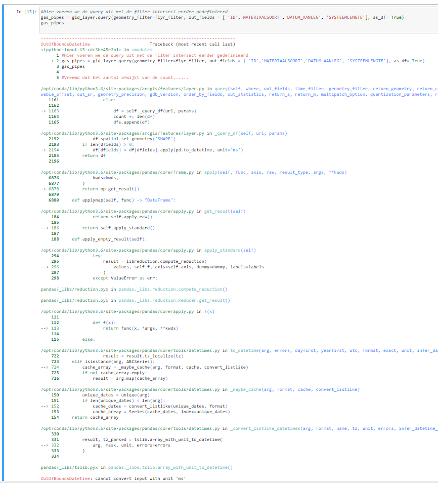

JoëlHempenius3
I think I will contact my distributor, because "as_df" doesn't work:
Your second suggestion also resulted in an exception.

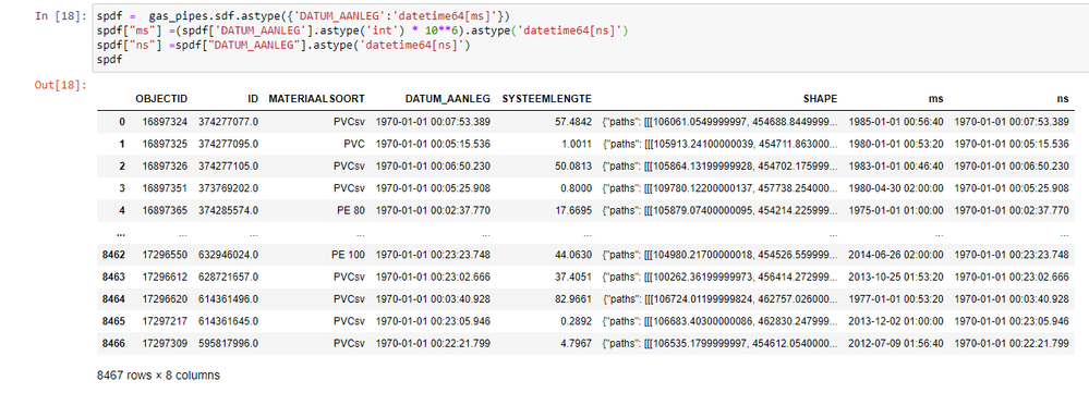

But finally:
Still going to contact my distributor, because it shouldn't be so difficult.
