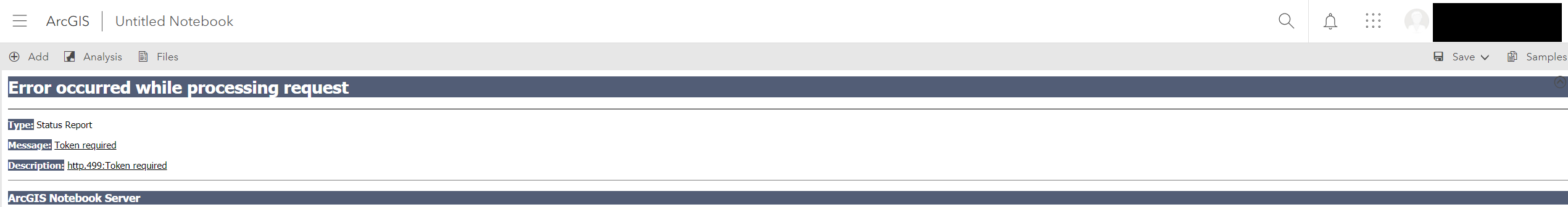

I have just installed and configured ArcGIS Notebook Server 10.8.1. Notebook was federated with ArcGIS Portal, I can successfully access  Notebook Server Manager where everything looks great, and I got a new tab in my Portal - 'Notebook'. However, when I try to open it, I get the notebook interface, but the notebook itself cannot be loaded. I get an error 499 stating that token is required.
Inside developer tools:
Which step of configuration am I missing?
I will appreciate any help!

Hi AZietara,
Thank you for this posting.  Is this using Java webadaptor on Linux? Can you try a different context name for the notebook server's webadaptor? Not sure if this might be caused webadaptor context named as "notebook".

Hello,
No, it is WA inside IIS on Windows. My customer wants to use Notebook for testing purposes, that's why it was installed on Windows. I have changed web adaptor name to something else but it did not help. Still getting the token issue.
