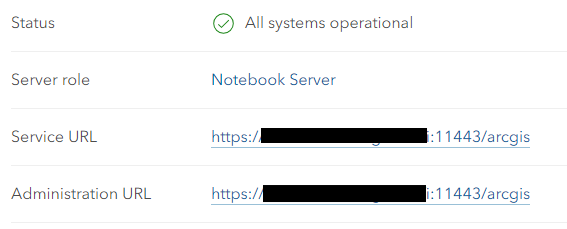

3. Federated the Server using https://vm-portal-fqdn:7443/arcgis/home/index.html
Server URL and Admin URL are the same now.

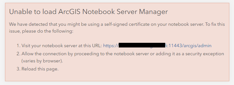

But when I went to the Notebook tab in the Portal, I got this error:

10. When I wanted to reach the Notebook tab using the domain-based URL: https://test-my.domain.com/portal/home/index.html

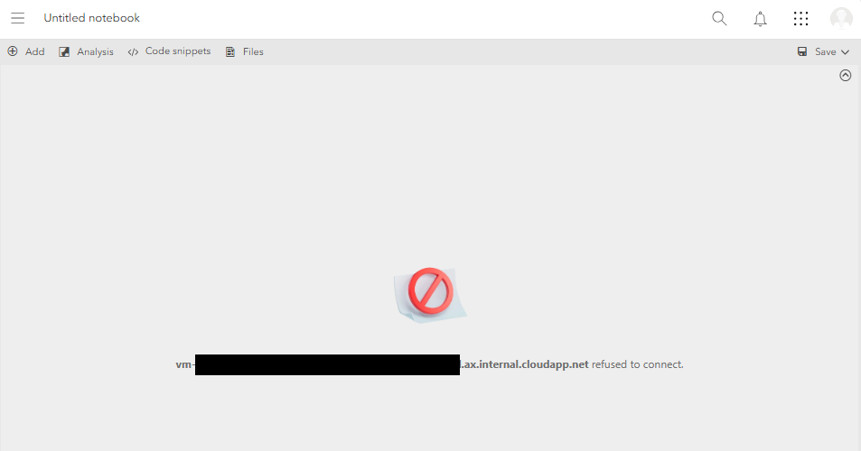

I got the same error message as in #3. To resolve that I made some additional changes, that caused another problem:
As a result I can't open any Notebook, neither from the https://vm-portal-fqdn:7443/arcgis/home/index.html nor https://test-my.domain.com/portal/home/index.html
