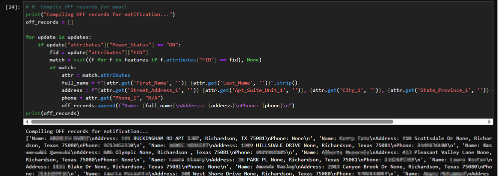

Context: Our organization has developed a python script in Jupyter Notebooks that scrapes an electricity providers website and compares the power outages with some of our at risk residents' addresses. If there is a power outage then it uses an email function to alert staff of those power outages. We want to schedule this script as a stand-alone script on a local server with task scheduler to run every hour.
^^^ Since there are currently no power outages, I updated the script to email us all those residences that have power on. (Should be all of our at risk population). This works beautifully in Jupyter Notebooks.
Issue: When I export the notebook as a stand-alone python script and run it in PyCharm, it doesn't provide the same results. During the test for those with power on it shows zero and we do not get sent an email.
Example results in Jupyter Notebooks creating a list: (the list is called "off_records" but it's really grabbing "Power_Status" == "ON" for testing purposes)
This is the result of the same exact script using PyCharm:
Help! Any reason why these results would be different?
Thanks for your time,
Shari

AustinAverill
It's apprent that from PyCharm, the variable "match" is not being evaluated as true. Unfortunately, we cannot really debug the cariable since its referencing something that is outside of what you provided.
Add more print statements to help you debug why your "if match" conditions is not being met.
ShariF
Thanks for pointing that out. I'm not sure how to share this script with you to see it all as it has sensitive data within it.
AustinAverill
Understandable. Unfortunately, without much more context, it's going to be difficult to offer any more advice beyond adding in more print statements for debugging. And double check the request you are making to the service you're scraping for data to ensure that it hasn't been altered from the notebook.

The layer with the sensitive info is locked not shared publicly but here's the script anyway. If something stands out to you please let me know.

AustinAverill
So, i think the issue is with line 104:
match = next((f for f in features if f.attributes["FID"] == FID, None))
My guess would be that you are not receiving any matches in this variable assignment, and therefor match is always evaluating to None and not executing your `if match:` condition. You could add a print statement after line 104 to to get what data is being assigned to the match variable and dive into why it isn't finding the match in your features data. You may also want to verify your data is matching correctly for FID - as in that they are both the same data type (string to string, int to int, etc.)
ShariF
THank you. I'll look into it.
