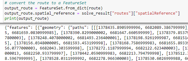

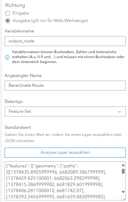

I have changed the coordinates of the input points as well as the name so that they represent German cities. The workflow to generate the route is the same as in the tutorial above. The route is also generated. I can plot it in the Notebook as a LineString. The geometry is not empty and is valid. It is also possible to convert it into a FeatureSet and the output of the route as a dictionary is entered as a default in the parameter window, when creating the output parameters.

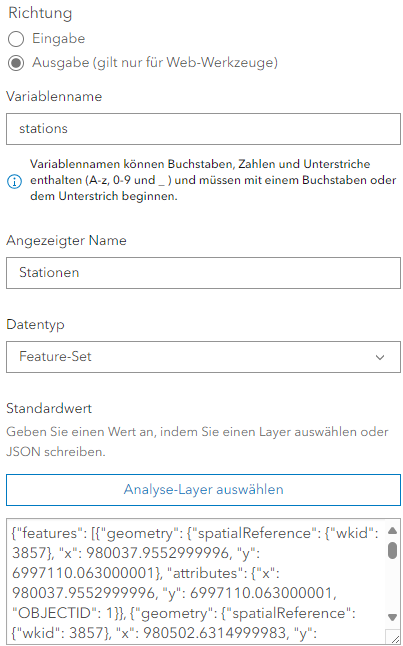

Even if the workflow changes from now on, as a different data set is used for electric charging stations, I end up with a FeatureSet with points (charging stations) around the route. I have also entered the dictionary of the charging stations as default in the parameter window.

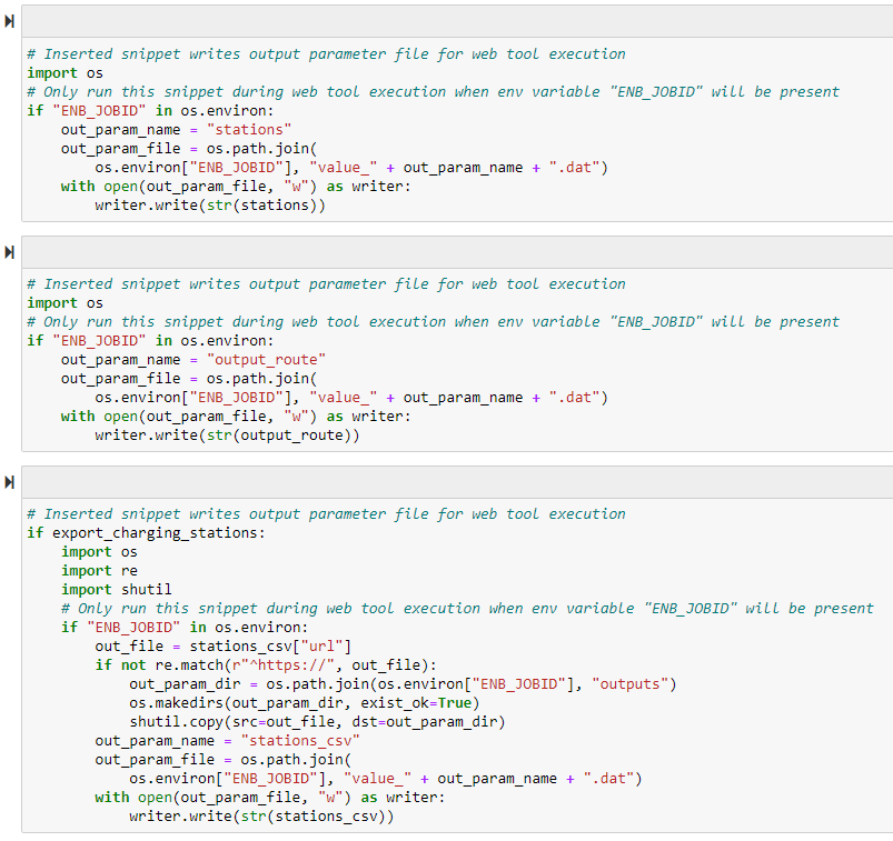

I have added the codes to create the output parameters at the end of the script. I checked if the variables fit to the code from the parameters.

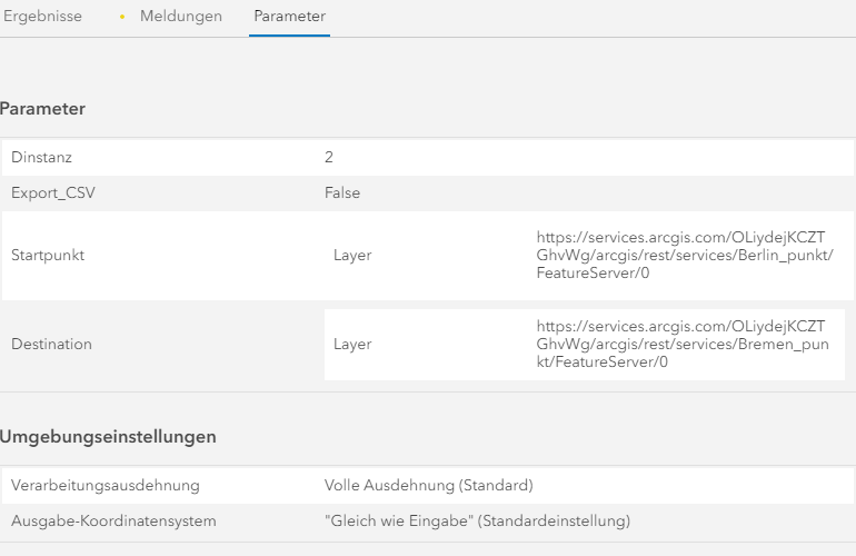

When i open the history tap of the executed Task and click on the parameters ribbon, only the input-parameters show. Is that a problem? Should there also be output-parameters?

Right now dictionary with a "feature":[] and a list of features. The feature look like this:
			"geometry": {
				"spatialReference": {
					"wkid": 3857
				"x": 980502.6314999983,
				"y": 6998179.386699997
			"attributes": {
				"y": 6998179.386699997,
				"OBJECTID": 2
each feature has a "x" and "y" attributes, because the sdf i created earlier had columns with these values and a SHAPE column.
Does each feature need a geometryType field or something else?
After the Features there are some other keys with values in the dictionary of the FeatureSet:
"objectIdFieldName": "OBJECTID",
	"displayFieldName": "OBJECTID",
		"wkid": 3857
	"geometryType": "esriGeometryPoint",
	"fields": [
			"name": "x",
			"type": "esriFieldTypeDouble",
			"alias": "x"
			"name": "y",
			"alias": "y"
			"name": "SHAPE",
			"type": "esriFieldTypeGeometry",
			"alias": "SHAPE"
Maybe that information helps to find the mistake in my Script.
