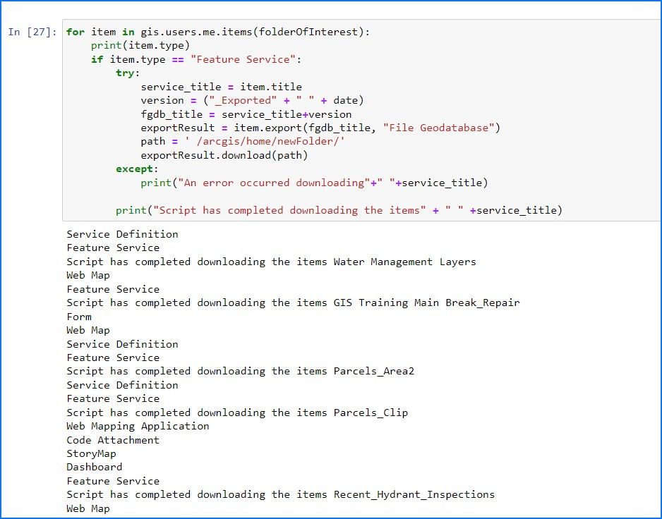

RonaldVanderpool
Hey Josh,
I have been through the various posts above and a fairly deep dive into Esri documentation covering working with content in the workspace but failing epically to find why my script will not export results to the arcgis/home in Notebooks.
The script I am using(before I modified it to represent details above) works great from Pro to download all of the AGOL folder feature layer contents to a folder on my desktop, zipping each feature layer individually, and naming them by the y_m_d when the script was run. It works great but I have to set reminders to do this for my systems on a scheduled basis.
My goal it to use the Tasks tool in Notebooks to automate the process so I do not have to worry about it.
Any rate, the script runs in Notebooks, but never places anything in the home folder.
Here is the last part of the script;
And any guidance would be appreciated!!!
