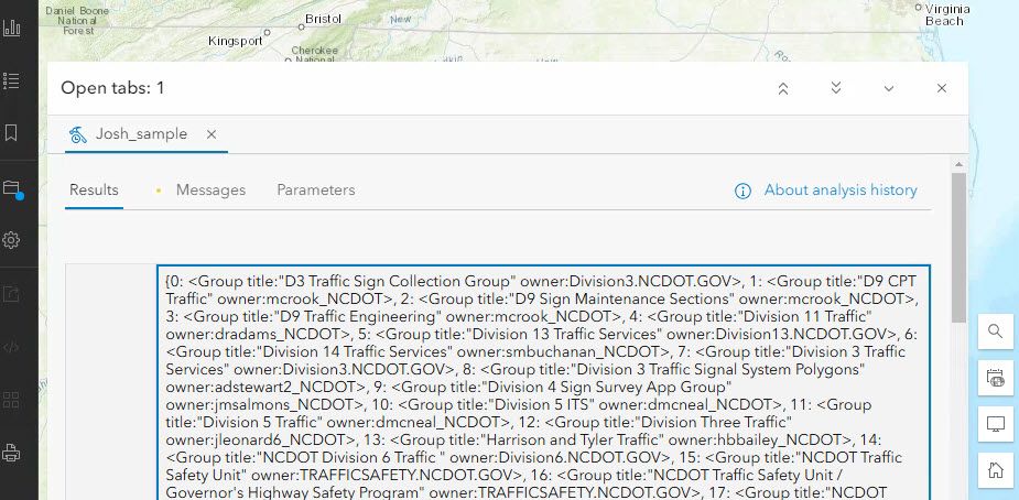

josh_sample.output.jpgFinally figured it out.   Still have a problem though...
I have the tool running now (added the output parameter: that's what I was missing before.)
So the tool runs and creates an output "STRING".   So the new problem is, what am I supposed to do with the output string that is displayed in the "details" page after the tool completes its run?  I'm not able to copy the text from that details window.
Anyone have ideas for that?

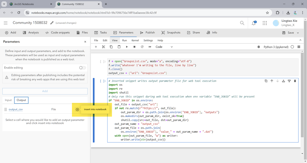

Thanks for your patience! I would like to suggest the following edits to your code snippet that creates a CSV file when the notebook is run as a web tool:
f = open("GroupsList.csv", mode='a', encoding='utf-8')
f.write("whatever I'm writing to the file, line by line")
f.close()

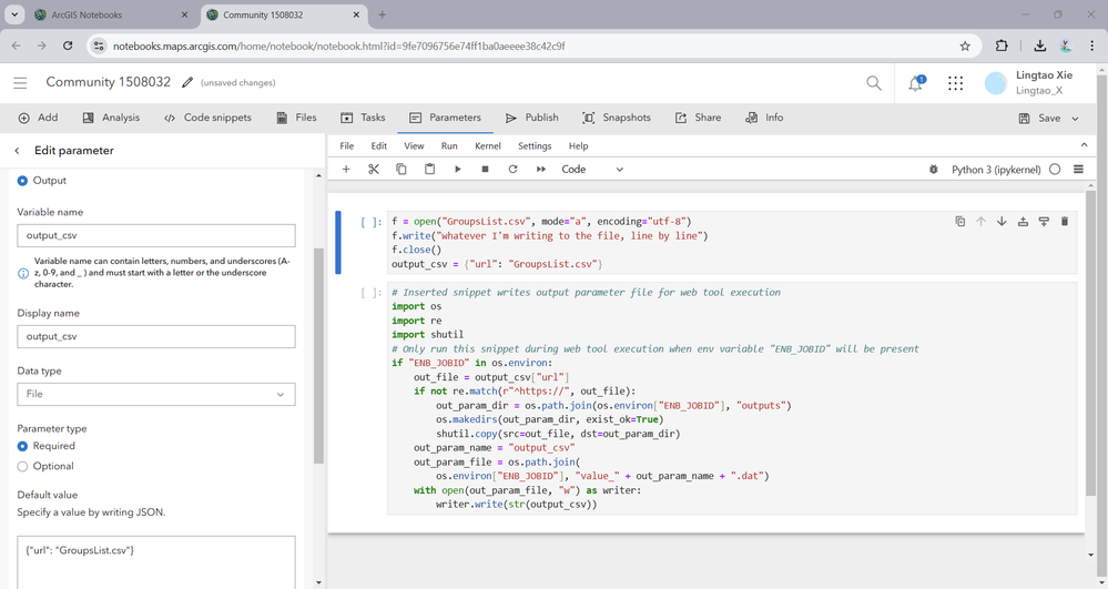

output_csv = {"url": "GroupsList.csv"}
Here is how the output parameter should be configured.

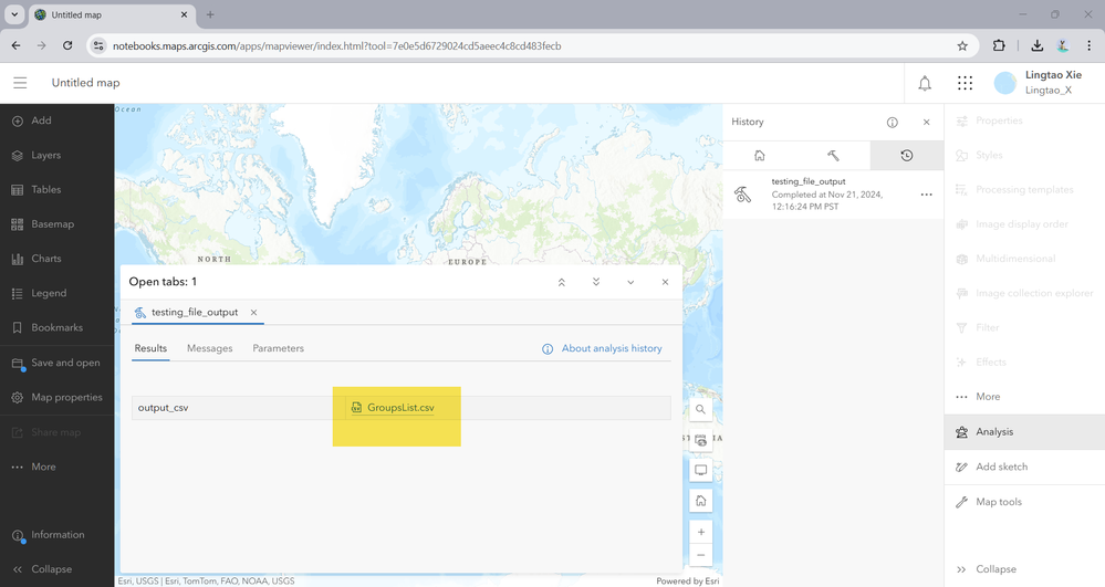

The second cell was inserted using the "insert into notebook" button. During a web tool job run, this cell sends the value of the notebook variable to the web tool job as an output parameter.
With the configurations above, the web tool should output a CSV file that you can click to download.
