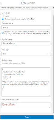

The next step would be to publish the notebook as a web tool in ArcGIS Online. To do this, we wanted to define an output parameter. The settings currently look like this:
A first question would be what we have to specify as a default value in JSON format. According to the documentation, it has to be a URL to an existing output? Currently, we have simply uploaded the Word template as an item in ArcGIS Online and specified the URL to it.

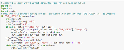

Afterwards we added this snippet at the end of the notebook:
The name of the variable equals the output variable name for the word file.

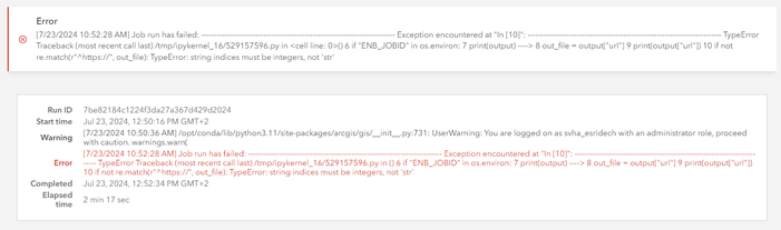

The tool can still be started, but aborts with an error message in the output parameter area.
It seems that the error is in the output parameter section. Do you have any clue, what we are doing wrong in the whole output parameter section (Notebook config, etc.)? The input parameters work.

  1. For the default value, if there is a URL pointing to a file that you want to default to, you can specify the default value as {"url": "<url-to-file>"}. Alternatively, since it is okay to leave the URL blank, you can specify the value like this: {"url": ""}.
  2. It is expected that the output parameters will not appear in the GUI before you run the tool. If you expect a value from the web tool users, please create an input parameter for it. Output parameters are what the notebook web tool will output after the tool finishes running and cannot be specified by the users.

  4. Could you please copy the error message in the last screenshot and paste it as text here? We are unable to read the error message very clearly. (The screenshot might have been compressed by the website when it was uploaded.)

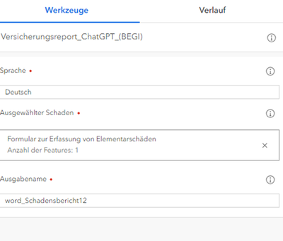

We are currently keeping {"url": ""} empty and have defined an input where the user can specify the output name. The .docx files are published as items in ArcGIS Online at the end. Our script creates a .docx file for each feature.
You asked for the error message. I don’t have access to it anymore because my script is working now. I think it was a problem with the specification of the output parameters and the URL we were pointing towards.

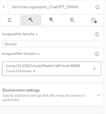

We want the user to select a feature on a map in the last step. The reports should then be created only for the selected features. This is possible in Experience Builder.
Apparently, the problem is that the selected features are not being passed along. Our input parameter is a feature set, but we still need to convert it to a feature set in the script. The selected features are being lost in the input. Do you have any idea what we need to set up to ensure the selection is considered?
This is our setting for the input features paramter:

@BenGiese @Sven_Harpering
Were you ever able to figure out how to just get the output to be from the selected map features in Experience Builder and not the entire table of the layer? I'm running into the same issues that Ben had described above. Even when I just have selected features as the analysis input into the custom tool, I think because I'm doing the same as Ben's script above of passing the "url" dictionary value in as a variable the tool is then ignoring the selected features. However, I can't figure out how to get just the selected features to operate as a usable variable in the tool without passing the "url" dictionary value.

here is the error message:
As Ben wrote, we have updatet the script already, so we are not using the output parameter any longer. But maybe it is still interesting for you.
