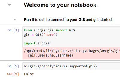

Hi Adam,
The reason you are seeing this error is because the calculate_fields is under the Geoanalytics module of the python API and requires a Geoanalytics server. If you're connected to an external GIS that might have a geoanalytics server installed, use the below command to check if your GIS supports geoanalytics.
arcgis.geoanalytics.is_supported(gis)
However, for the default GIS in Online, this will return false as geoanalytics is not supported in Online.

AFackler_NAPSG
Thanks for your answer, @Anonymous User!
Here's the funny thing. When I put in that script, it returns "True" but still gives me the same error. Any guidance from here? And if there is no field calculate available, is there an alternative?

NoahSlocum
Hi @AFackler_NAPSG , the reason you are still seeing this error is that arcgis.geoanalytics is not supported by https://arcgis.com, it requires a base deployment of ArcGIS Enterprise and a licensed GeoAnalytics Server to run each function. There is an issue where arcgis.geoanalytics.is_supported() will incorrectly return True in the case above, we are working on fixing this.
If you don't have ArcGIS Enterprise and a GeoAnalytics Server you could instead try to create a Pandas DataFrame or Spatially Enabled DataFrame, add a column and calculate time using python's built-in time module, and export the DataFrame to a Feature Layer.
You could alternatively add a field directly to the layer using this example and edit your features to populate the timestamp.
