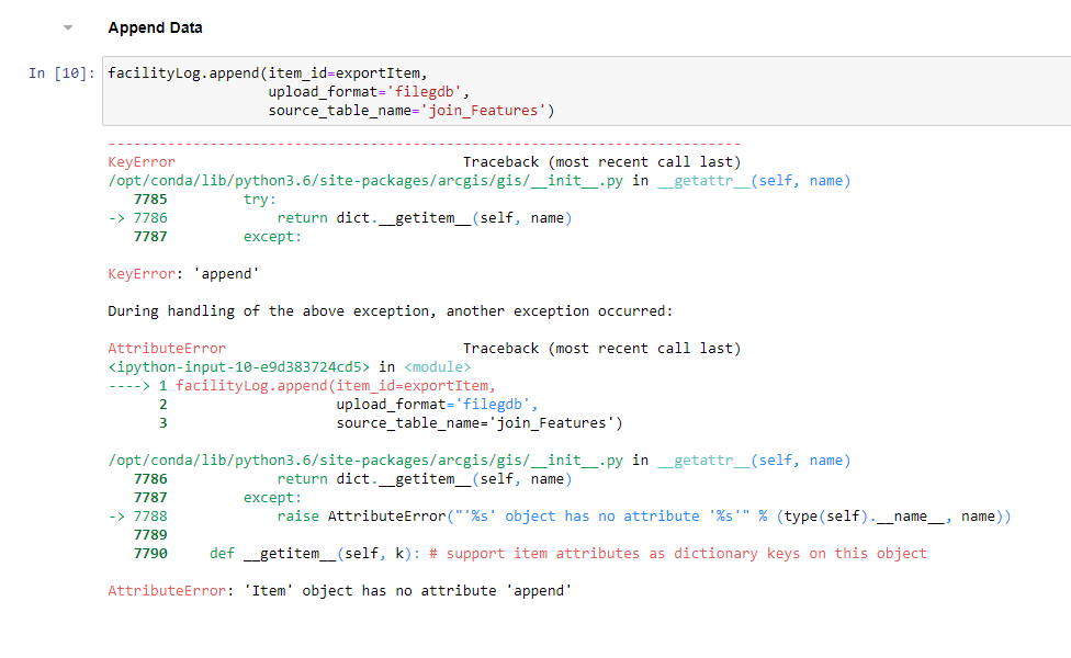

I am trying to do some work that appends a geodatabase that is on ArcGIS Online to an existing feature layer using the append function (as part of an archiving data effort). However, when I try to run this part of the script, it gives me the error that is seen below. The fields should match perfectly. Can I even pull in the geodatabase from ArcGIS Online or does it have to come from my local computer? If it has to come from my computer, is there a script or tool somewhere that I can download that database locally?
Thank you in advance!
jcarlson
MVP Alum
Based on the error message, it looks like you're trying to run the append against the Item.
Append works against a FeatureLayer or a Table. In order to get that from your Item, you'll need to use the .layers or .tables properties.
facilityLog.layers[0].append(...)
facilityLog.tables[0].append(...)
If your service has multiple layers/tables, just be sure to use the proper index number in .layers[x].
