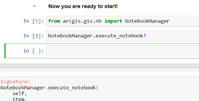

Hi @StuartMoore  if you may try the following.
Thanks
Shikhar Deep

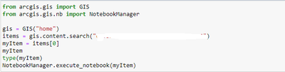

Hello everybody,
working in Agol and trying to execute a notebook
is it the correct syntax?
i have an error message but the myItem var is a arcgis.gis.ItemDISIG_1-1670314672035.png
usdajoy
@DISIC Did you every figure this out? I am stuck at the exact same spot with the same error.
GLCAdmin
I think you just need gis.content.get rather than gis.content.search
