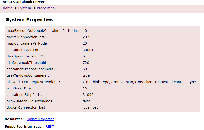

HI @JasonHarshman ,
Could you please share the details of system properties from the ArcGIS Notebook Server Administrative API?
Thanks,
Shikhar Deep
JasonHarshman
@shikhar_deep see below.
JasonHarshman
I just noticed the useWindowsContainers parameter is set to true. Changing it to false fixed the issue. Thank you, Shikhar!
