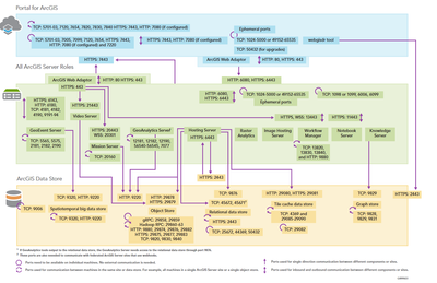

Have you tried temporarily disabling the firewall on the server since it's an intranet device? What leads me to think it's still a port issue is the api problems. Once disabled, I would check the status of the Notebook to see if it's able to run. I would also follow this chart and ensure all ports on your devices listed are opened:
Let me know if this doesn't end up helping and I can look further!

Thanks for the reply! I will need to get with the Firewall folks on Monday to test that theory.
I was able to use Test-Netconnection from my Portal VM and it succeeded.
We have also provided them a list of all the ports used by ArcGIS Enterprise according to that document you attached to be included in the Allow list. So that is what is leading me away from thinking it's  a port issue.
