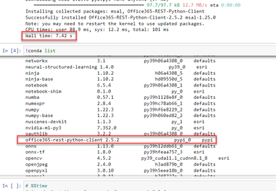

Hi @DavinShokes1 - yes you can add packages to the Online Notebook via conda or pip.  However, this package is only available for the duration of the notebook session--once you close the notebook or the container, this package is no longer available.  In other words, the package won't persist in the runtime manifest, you have to run the install command in each notebook.
I just tried to install the Office365-REST-Python-Client in an Online notebook.  It took 7 seconds to install.

DavinShokes1
This works great. Thanks alot!
