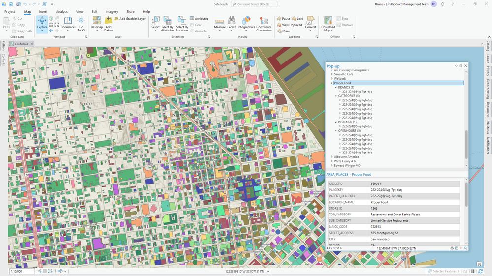

My example uses Esri business partner SafeGraph Places data, with their kind permission, for which I am grateful.  If you follow the link you'll see that Places model point-of-interest data.  Places have geometry (polygon or point) and attributes.  Some of the attribution is best modeled as related data, and you can see from the map popup my data model has four lookup tables for places to expose the brands, place categories, web domains and open hours known for a place.
San Francisco PlacesSan Francisco PlacesSan Francisco PlacesSan Francisco PlacesSan Francisco Places
The main topic of this post is using an Online notebook to maintain a hosted feature layer with source data from an internet connection, namely a cloud warehouse, and without compromising data preparation or data model flexibility - expanding JSON columns and creating relationship classes is shown.

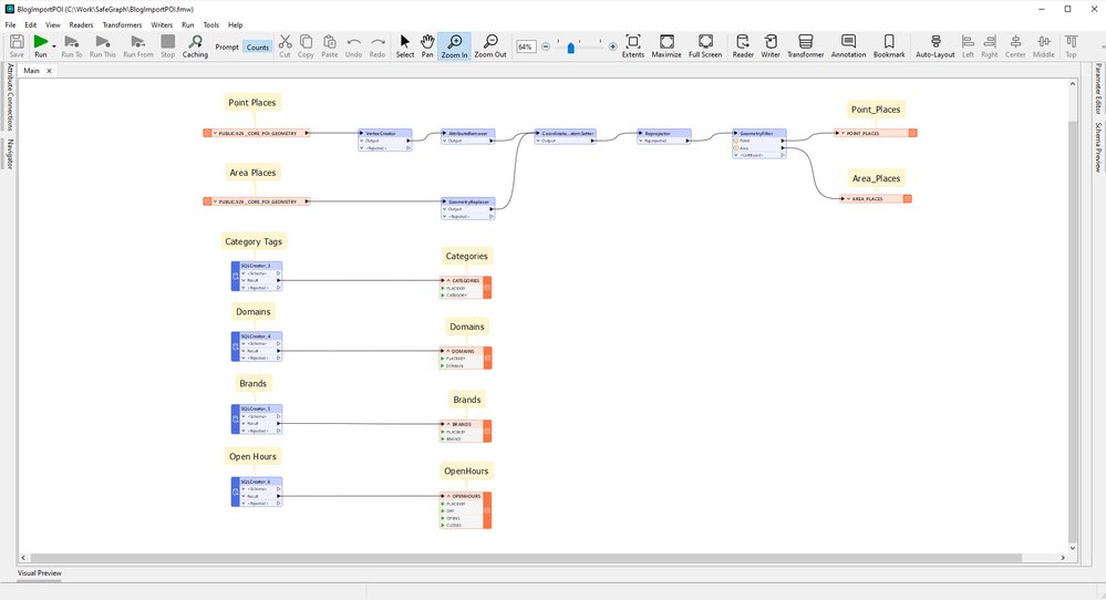

This post does not have a dependency on ArcGIS Data Interoperability, but does include an ETL tool that is an option to create an initial file geodatabase used to publish the target hosted feature service, otherwise use the supplied XML Workspace document to do this.  If you do have Data Interoperability the supplied ETL tool looks like this:
BlogImportPOI.fmwBlogImportPOI.fmwBlogImportPOI.fmwBlogImportPOI.fmwBlogImportPOI.fmwImport PlacesI'm accessing SafeGraph's data from their Snowflake Marketplace entry, access to this is provisioned by SafeGraph.  When you connect with a Marketplace entry it becomes an available database in your Snowsight console and through any connecting technology like an ODBC connection or REST API Snowflake offer.  I could have generated my initial geodatabase by adding a Snowflake database connection in ArcGIS Pro, creating query layers, and using core geoprocessing tools.  I just found it easier to make a Spatial ETL tool.

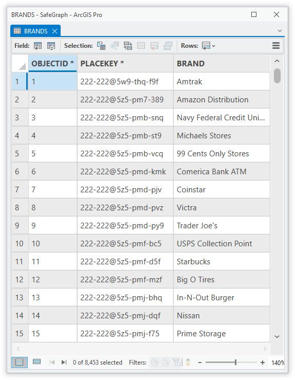

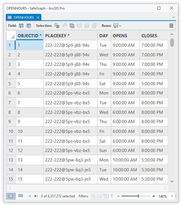

I'll let you inspect the SQL I used to unpack each JSON document type when you look at the code in the notebook in the blog download, but the tabular results for brands and open hours look like this:
Brands:
BrandsBrandsBrandsBrandsBrands
Open Hours:
Open HoursOpen HoursOpen HoursOpen HoursOpen Hours
