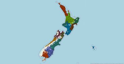

2.3 Million Point Features2.3 Million Point Features
My data is in 12 feature classes, you can have any number.  The pattern I will show works with data split into separate parts that can be processed concurrently.  If your data is monolithic then either split it yourself spatially (oriented fishnet anyone?) or by adding a field signifying a batch identifier populated by row position - you can drop the field during processing.

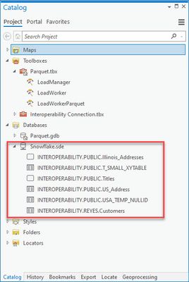

Now back in core Pro 2.9 my data is loaded to Snowflake and I can throw queries at it and enjoy the scaled compute experience.
Snowflake in Catalog PaneSnowflake in Catalog Pane
