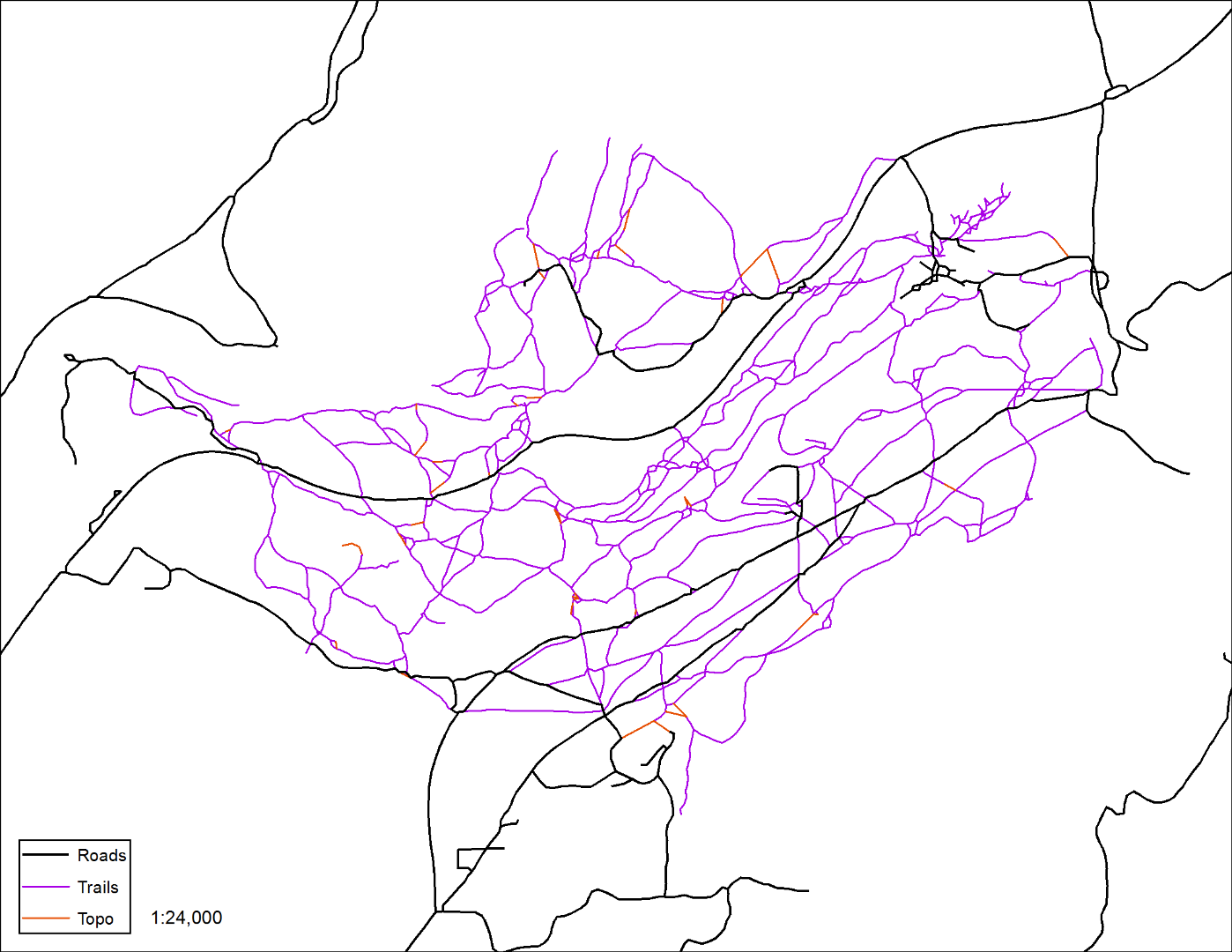

Task: I have a large maze-like network of hiking trails for which I need to walk along all of them and update centerlines, conditions, etc. There are so many and the network so complex, that I think it is worth the effort to plan out my routes rather than just wing it and more than likely waste a lot of time and effort in backtracking and filling in missed spots. I think a Vehicle Routing Problem is the best way to go about finding those ideal routes.

Trails_Topo: 'Trails' edited to be topologically useful, more or less. No overlaps or gaps, those kinds of things. (The red parts in the picture are extensions to make the topology better or where I believe trails may be but are just not in the original data.)

1. I cannot see a way to tell NA, "I need to travel on all these lines. These other lines MAY be used as shortcuts or whatever as needed". All I can see is how to make lines and polygons that the VRP won't go over/through, which is fine for my Study Area things, but not so much for finding efficient routes. I also cannot assign lines as 'Orders' as the VRP wants destinations to exist as. I worked around this by using Points-from-Vertices for my trails and input all those ~2500 points as orders.
