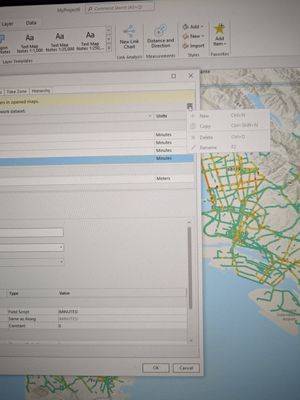

MelindaMorang
You have to remove the network dataset and any NA layers referencing it from the map or you can't edit the network dataset properties.  That's what the yellow warning on the top of the properties page means.

PolinaKoriakina
 example with one of Esri Tutorial I've opened, where is not possible to adit costs.
MelindaMorang
PolinaKoriakina
Thank you very much! It worked. I should not just ignore this message.
