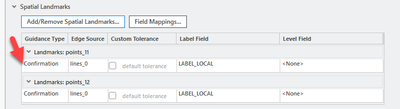

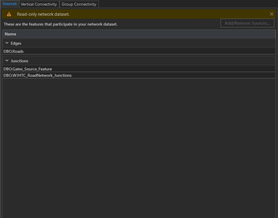

If I understood you correctly, it is not recommended as have the same "feature class" as both a junction and landmarks. In my case I have two feature classes: Gates_Source_features, which is added as a junction under the source features tab; and Gates_Landmarks, which is added under the spatial landmarks tab. You can see them below.

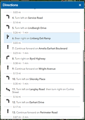

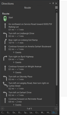

Below is the print out of the route layer in ArcGIS Pro, this route travels through 3 different gates and should have the name of the gate show up between "Bear right on Linberg Exit Ramp/Continue forward on Amelia Earhart Boulevard", there is a gate right after "Turn right on Byrd Highway", and the final gate is between "turn left on Earhart Drive and Continue forward on perimeter road" However as you can see they don't show up in the directions.
Attached below is the same route that is run on our Enterprise portal and it has the same issue.
