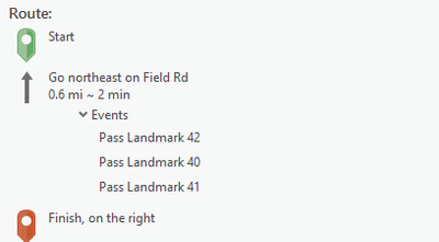

RachelApplebaum
I noticed that in the screenshot of Pro that you provided, the one in dark theme, below the directions instructions, there's a part for Events, and that's where the landmarks get reported.
When you expand Events, does that show the correct reporting of the landmarks?
In some sample data, I copied some system junctions to a new feature class, gave them names, and set them up as landmarks. When I solved a route for that area, I did see the landmarks reported under the Events expander.

BrandonMcAlister
Well that is a weird way to show it, but glad to know its working in ArcPro. Do you know if there is a way to have it show up as a step and not be hidden in a drop down "event" menu?

Hi Brandon,
I'm sorry this took so long but I have an update. The Directions widget in Map Viewer Classic won't show spatial landmarks. Even the new Map Viewer doesn't show the spatial landmarks, although it could, because it has the information; it just doesn't show it. We're working on getting it updated. I don't have a timeline for you on when it will happen, but please know that we do want it to happen and are moving towards it.
