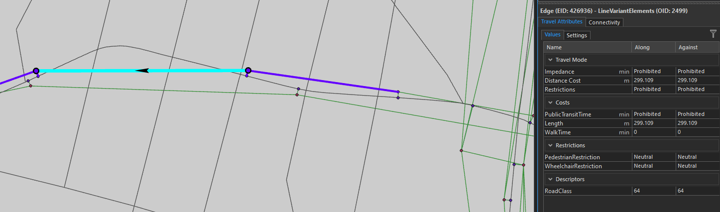

I noticed in your screenshot showing the table from Explore Network that the transit line is showing Prohibited in both directions.  That makes it seem like a problem with your cost attribute, restrictions, or travel mode.  Note that you can flip over to the Settings tab in the Explore Network pane and choose which travel mode to use with the tool, so I can't tell if you're just using the wrong travel mode in the tool or if this is actually a symptom of the problem you're trying to diagnose.

Thank you so much! It was the first solution you suggested--I was using a generic day of the week and didn't even think to assign a specific date, silly me.
