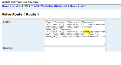

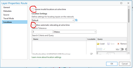

Hi I've tried to overwrite service (AGE 10.9.1) with Pro 3.0, and 3 meters tolerance settings.
But solve find route also if Stop#2 has an exagerated "Z" (see below for the image)

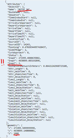

DamianoMontrasio
Hi all,
please there's anyone in ESRI tha can explains me why Network Analysis at Enterprise 10.9.1 for Stops z value snaps from 1000 meters to 2, when Max Snap Tolerance: is 3 Snap Tolerance Units: esriMeters?
I've set these preferences in ArcGIS Pro:
If I move Stops1 of 5 meters on Y I obtain correctly that Stop1 is invalid.
Why not on z values???
Thanks a Lot!
Damiano
MaxZeng
Hey Damiano,
We identified this is a known issue when locating. We didn't account for Z values when applying search tolerance. We plan to fix the issue.
Thank you for brining this issue to our attention!
