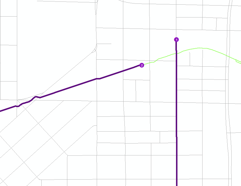

DanSeidensticker
I'm building a simple (or so I thought), network using two features; streets and bike paths, but I'm unable to get Network Analyst to use the connections where a bike path crosses a street.  The route result takes a major detour as shown In the attached image. The streets are gray; bike path is green.
Both the street and bike path features have populated from/to elevation and one way fields.  I have both features in one connectivity group set to Any Vertex (also tried End Point for both).
Any thoughts on what I'm missing? When doing the route analysis it works correctly when both the origin and destination are on streets, or both on a bike path, but not not when one is a bike path and the other on a street.
DanSeidensticker
The problem is with using Elevation fields and Any Vertex Connectivity: Problem: Connectivity isn't established properly when using an Any Vertex connectivity policy and el...
My solution was to merge the two features classes and split the lines at intersections before building them into the network and then use End Point Connectivity. Be sure to update any necessary fields after spitting the lines such as those with distance.

MelindaMorang
Are you sure that both the streets and the bike paths have vertices at the locations where they cross?  If not, they won't connect, even with Any Vertex connectivity.
You can add vertices at the points of intersection using the Integrate tool with a 0 xy tolerance.  Make a back-up copy of your data first, just in case, because the tool modifies the original data.
DanSeidensticker
Thanks Melinda, integrating the two features is exactly what I need to do. For some reason I was thinking the vertex connectivity would also apply to edges that crossed over each other.
