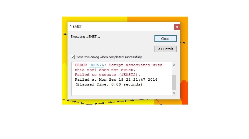

That is a good idea, I converted the lines to points but I got this error:
DanPatterson_Retired
MVP Emeritus
strange... did you unzip everything in the same folder? and add the toolbox to arctoolbox?
If there are bits missing Lano, Let me know and I can fix the update in about 8 hours (not on, or near my 'machine' sorry)
