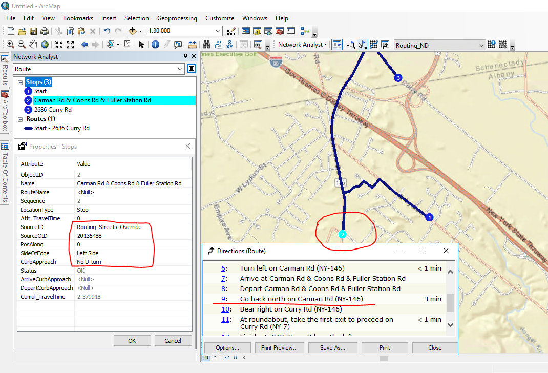

Hi All,
    As the document mentioned, "Currently when a network location is on a junction, the ArcGIS Network Analyst extension allows U-turns there, even when its CurbApproach property is set to No U-Turns and the U-turns at Junctions property of the network analysis layer is set to Not Allowed."
   My question is when the stop is set as a street override (As we don't know which direction is best for the crossroad), how to avoid a U-Turn in this scenario?
   The U-Turn policy is "Allowed Only at DeadEnds".
   Environment:
   ArcGIS Desktop 10.6 with Network Analysis Extension
Thanks,
Leo

Hi Jay,
    Thank you for your explanations.
    Set the stop source as streets could avoid a U-Turn certainly, however is there any solution in network analysis to avoid U-Turn when the stop is set at the junction?
    As you can see in the result, there is a U-Turn. We want to avoid the U-Turn in the results and also keep the stop at junction point. Since we don't know which direction for the stop in the crossroads is correct before the route analysis.
    Image that there are lots of waypoints set in the junction, the vehicle will go through these crossroads. And we also not allowed U-Turns. How can we implement it in ArcMap?
Thanks,
Leo

LeoDeng
Hi Jay,
   > Why do the waypoints need to be on junctions?
    As we don't know which position in the crossroads is the best choice for the route.
    Put a barrier and combine the results could be a solution.
Thanks,
